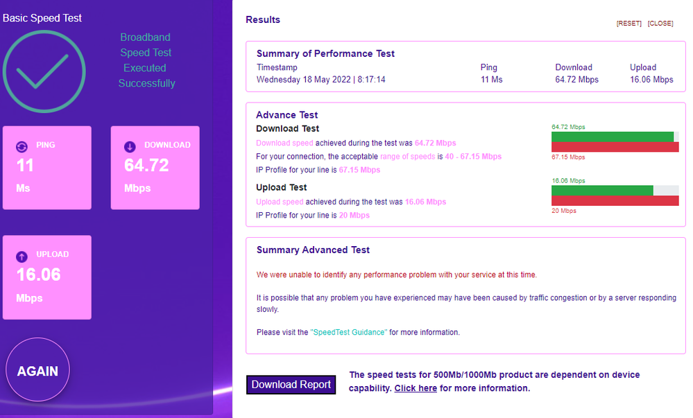

As with all intermittent problems, Murphy's law applies. Currently testing fine (see below). I'll try to run a test next time it's going slow (which only seems to be afer 11pm), or immediately after the connexion has dropped and reconnected, just in case.
I don't have a phone. But I'll see if I can borrown one for a Quiet Line Test.

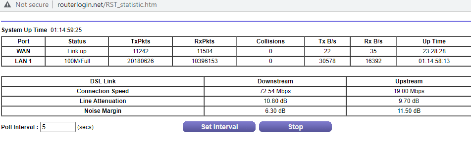

And the bit that's probably going to make this harder for me: I'm not using the stock plusnet router. We had problems with WiFi range, and I couldn't get it to work as a bridge for my Linksys router (WRT1900AC). So I've been using a Netgear DM200-100EUS, pretty much since day one. But it's never had any problems.

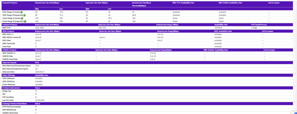

Broadband availability checker 0823 18-05-2022.pngBTW Performance Tester .png

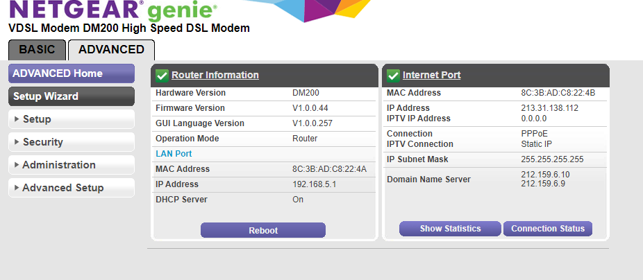

More ionfo from modem.Screenshot 2022-05-18 091918.pngScreenshot 2022-05-18 092022.pngScreenshot 2022-05-18 092100.pngScreenshot 2022-05-18 092142.png
