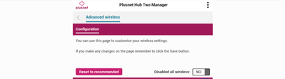

Thought I'd chek the thread, here is the wireless screen in Advanced settings
Screen shot from my smart phone so it might look slightly different.
Make disable wireless Yes
HTH
