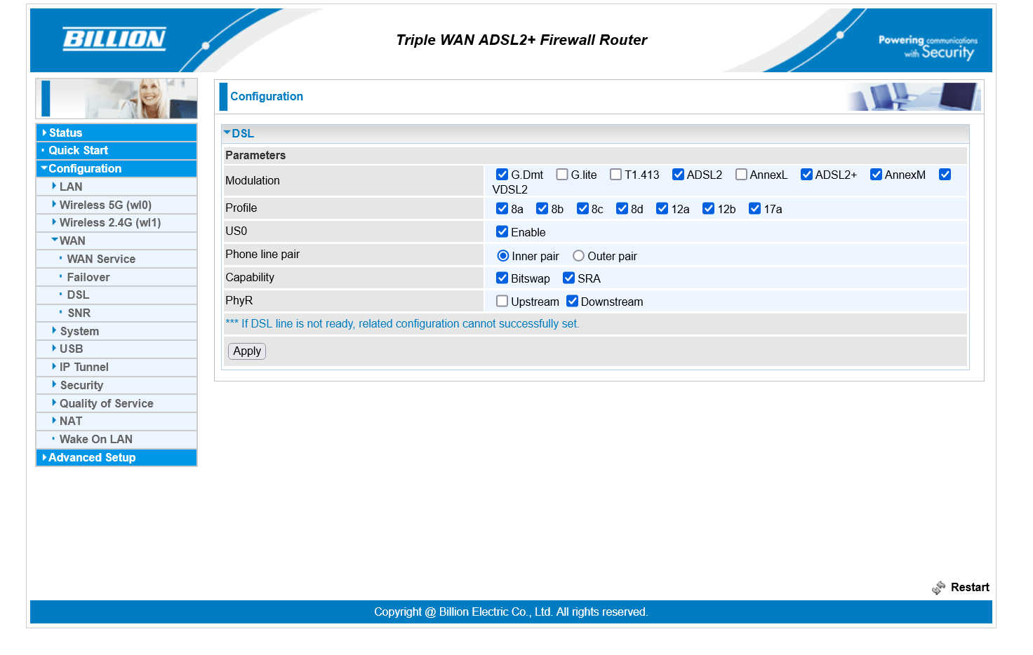

@MisterW really appreciate you taking the time to try to help me and I'm sorry to be dull, but which manual?  I am indeed already on Plusnet and they are sending me a Hub 2 which I want to use in bridge mode.  If I select the DSL page in my router interface then this is what I get.  I can't see an Ethernet/Ewan port or anywhere to toggle VLAN

@Junkman I'm looking at the manual downloaded from here http://www.billion.uk.com/esupport/index.php?/Knowledgebase/Article/View/413/123/bipac-8800axl-r2-fu...
Are you sure yours is an 8800AXL ? If it is , then you don't need the Hub 2 at all.

Thanks very much for guiding me to that.
So I think I need to add a WAN port on the WAN Service page using my Plusnet credentials and VLAN set to -1?
Posts: 18,579
Thanks: 7,932
Fixes: 531
Re: Idiot's guide to bridge mode
Correct
Except as I said above, you don't actually need the Hub 2 at all. The 8800 DSL port can support VDSL2.
