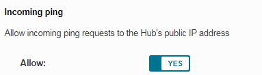

First problem gents. How do I get this back? I have a Fixed IP with Plusnet and it's linked to that, but these changes have stopped it working. Most useful tool to monitor latency, packet drop and drop-outs. Looks like it was working when I first set up the new arrangement successfully but has lost it since? Just checked and I'm still on that same fixed IP.....
Ah - might have sorted it. Hub 2 default is not to allow incoming pings
yep, that'll do it...

For BMQ to work you need to enable Incoming Pings found in Home >Advanced Settings >Firewall >Configuration look for
Edit: did you save the change ?
