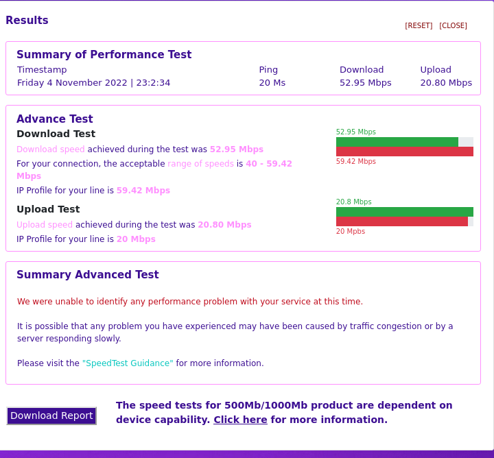

Re: How many reconnects before becomes an issue?
Hi
Download speed is connecting at 64472Mbps. But getting 52Mbps when doing a test.
Upload speed is 19999Mbps and getting 20Mbps
Attached images :
BT Wholesale test report.
Router stats page (switched back to the TP-link to see error rate easier)
Posts: 28,683
Thanks: 12,894
Fixes: 240
Those stats look better. The attenuation is circa 12dB again and you’ve broken through the 55mbps capping. There’s much merit in leaving things as they are and see how long they last.
A difference between sync speed as reported by the router and data speed as reported by speed tests is to be expected.
