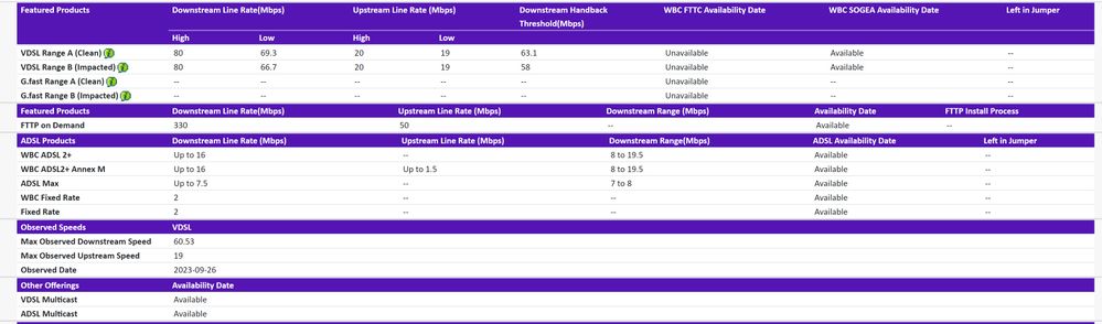

Sorry for not including :
Data rate:19 Mbps / 60.368 Mbps
Maximum data rate:22.666 Mbps / 61.393 Mbps
Noise margin:8.0 / 6.1
Line attenuation:7.5 / 14.9
Signal attenuation:7.5 / 15.2
I was on 79mbps up and 19mbps down before joining PN in July, I did post previously about the sudden drop in DL speed, but because my actual DL speed was above the 51mbps guaranteed, actual 54mpbs there was nothing PN would do?
They are investigating now as my DL speeds are horrible, hence why I was trying to work out if the SNR was related?

Just to throw this in too for your viewing.
Posts: 30,508
Thanks: 6,965
Fixes: 1,495
Re: Help explaining SNR please.
Your speed is below the handback threshold, so I would be reporting it!

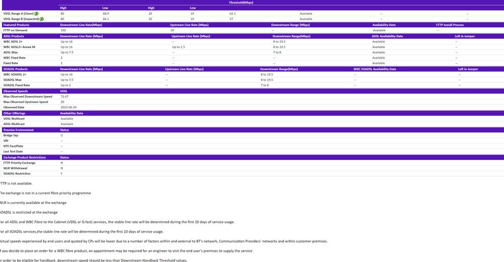

I did find these from when I got connected in July, you can see the differences to the above.
