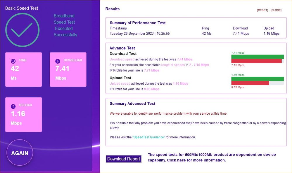

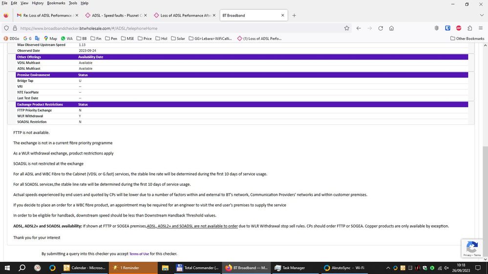

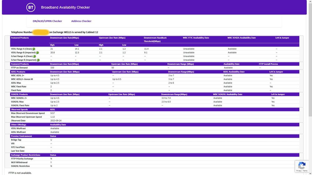

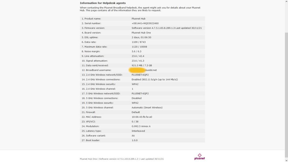

BT BB Checker - Top of ScreenshotBT BB Checker - Top of ScreenshotBT BB Checker - Bottom of ScreenshotBT BB Checker - Bottom of ScreenshotBTW ResultsBTW ResultsHubOne HelpdeskHubOne Helpdesk

Taking those shots in order: The 'observed speed' suggests that you are getting about 9.6Mb/s to your master socket, so your actual speed in the speedtest results is not unreasonable.
Given your attenuation, a 3dB noise margin target is not a good idea - it won't take much to disrupt your connection with so little headroom. You also appear to have only had a 2 day xDSL connection - have you caused this, or is it a failure of the Openreach network?

Sounds like there was a burst of errors a couple of days ago, this caused the target SNR to be put back to 6db and thus a resycnh at a reduced speed. Assuming the line stays error free , then eventually the target SNR should/may go back to 3db.

Not sure why you say it looks like I've been connected only 2 days?
Because the router stats say :- DSL Uptime 2 days 01:06:30
