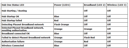

Did Plusnet support see the device dropping it's connection?
Have you noticed if the LED goes green after it fails as this would indicate a reboot has occurred. LED status meanings
Depending on the ambient light I would say Orange and Red can be difficult to differentiate.
Can you check the Hub One event log, from the home page http://192.168.1.254 navigate to Troubleshooting >Event Log look for watchdog reset (cause 0xn n = 0,1,2 or 3) message around the time the fault occurred, this could indicate your Hub One is failing.
