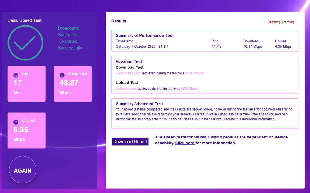

Alrighty, these are what I've got. Download speeds do seem slower than they were. I'm sure I was pushing 8mbs download speed before, now getting 6. But not drastic stuff. My bill reminds me: "Estimated download speed: 64 - 72Mbps"
This is ethernet & only one device connected.
Posts: 22,745
Thanks: 7,951
Fixes: 334
Re: Getting a lot of drops. Does plusnet throttle users?
Sorry for the late reply, but I got distracted last night. From what I can see above, and with reference to the earlier error log snippet, I suggest you report a Broadband fault to PN, using this link: https://www.plus.net/help/report-a-problem/broadband/

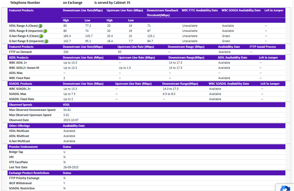

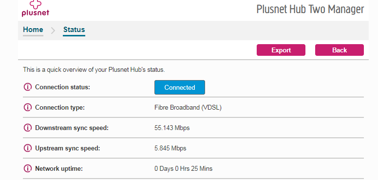

@alexrpm
For your future reference, your hub screenshot shows that you are syncing at a speed, (55 Mbps), significantly lower than the "Downstream Handback Threshold", 71/67 Mbps, from the third screenshot.
If I saw that consistently on my line, I would be straight on to Plusnet, (as @jab1 has advised).
