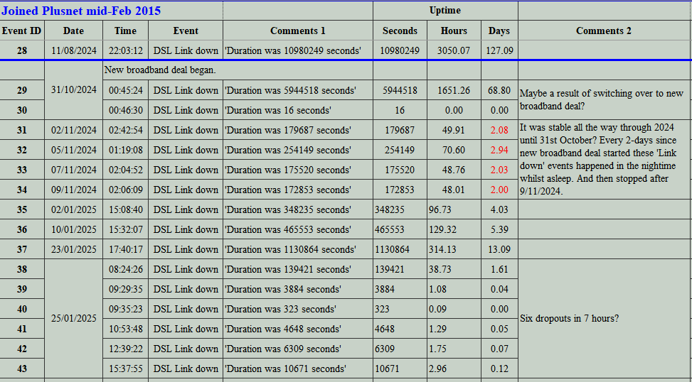

I have studied my log of dropouts some more (see photo) and I see that the dropouts frequency increased from 31/10/2024 when I took out a new faster broadband deal with Plusnet. Nothing changed at my end except the download and upload speeds increased so I wonder if the speed increase has made the connection more unstable?
The dropout on 11/8/2024 was 127 days after the previous dropout but now the maximum has been 13 days but often less.
Can anyone get Plusnet to check my line please?

Thanks for running the tests but although the line itself may be okay could it be some setting at Plusnet causing more dropouts since new faster broadband deal began on 31/10/2024?
I was getting 37 Mbps on the previous deal and now I am getting 50+ Mbps download and I was wondering if a Plusnet setting is pushing more data than the line can reliably handle.
Or could it be the Hub Two itself or its PSU?
