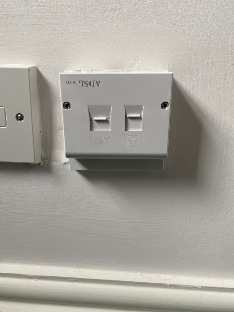

Hi, sorry for the post, I’m a bit of a tech novice.
My partner and I have just brought a house on an unadopted road. We’re not too sure about the broadband infrastructure to the house.
Plusnet have suggested we’re able to get Fibre with average download speeds 59 - 72Mb.
I’ve just started the process and it’s asking if we have an open reach port in the house. All we’re able to find is a split ADSL port.
Will this work, or would we have to have an open reach engineer come to install a different port?
Thanks in advance and sorry for the post!

@Mutleybm Can you post a picture of this  'port', please?

@jab1 here, thanks

@Mutleybm That looks as though it would be OK - BUT it does not look like a BT/Openreach installation, and it is mounted upside down! Do you know what service the previous occupants had?

According to that, @Mutleybm , you should be able to get a service, but I'm intrigued as to why that is not an BT/OR socket.
It looks like Plusnet were correct.
You shouldn't need an engineer visit,
You'd simply plug in your new Plusnet router in to the 'computer' outlet on your Master Socket faceplate
Re: Fibre with ADSL port
@jab1 wrote:
... but I'm intrigued as to why that is not an BT/OR socket.
It probably is a BT/OR master socket, but fitted with a possibly third party faceplate - I have several (but not that one)
edit: after looking it up, that faceplate appears to be a very early model supplied by Openreach !

@Mutleybm
Can you post a picture with the face plate taken off.

@Anonymous Thanks - but why is it upside-down?
@bmc I was just about to post the same request! 😉
Australian import ?  Cheesy
or perhaps the engineer was bending over while fitting it ?
If you do take the faceplate off,  while you're there you might want to measure the height and width of the back box ?
Knowing the back box size (in mm),  we might be able to recommend where to get a more modern filtered faceplate,
or better still fit a replacement single outlet phone socket faceplate - as filters aren't required on SoGEA broadband.
