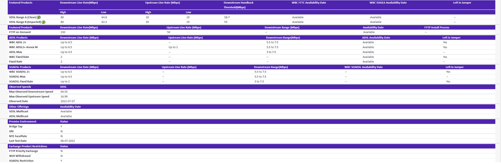

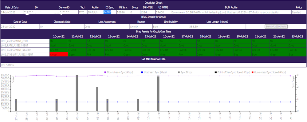

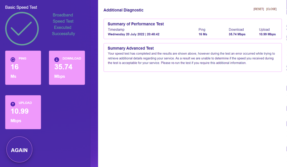

I have got some screenshots, we do not use the PlusNet hub router as we have a Tp-Link Archer vr600

@louie_the_cat Thanks for that information. Assuming the tests were run over an ethernet connection, there is obviously something amiss here. It is unfortunate that (a) the advanced diagnostics didn't run, but they quite often fail for some unknown reason, and (b) that you don't use a PN Hub. I have no experience of the vr600, but assume it has a page/window that gives data which shows (as a minimum) the connection speed, SNR values and DSL uptime?
The BT Broadband result (2nd picture)  is not really helpful either, as it is a fortnight out of date - not your fault. Would it be possible to try re-running both those BT tests again tomorrow to see if they run properly/give more up-to-date data?

The DSL checker does show a Bridge Tap which suggests a problem with your wiring or close to the house.

@adam945, the timestamp on that GEA Test is from nearly 2 weeks ago.  Could that be why it is showing a faster sync and no  bridge tap?

I think that's an error on BT Wholesale's side to be honest, KBD tests are done in real time, I'll pop our RRT below as well which is always a day behind, looks to match the data shown on my GEA test. Smiley
