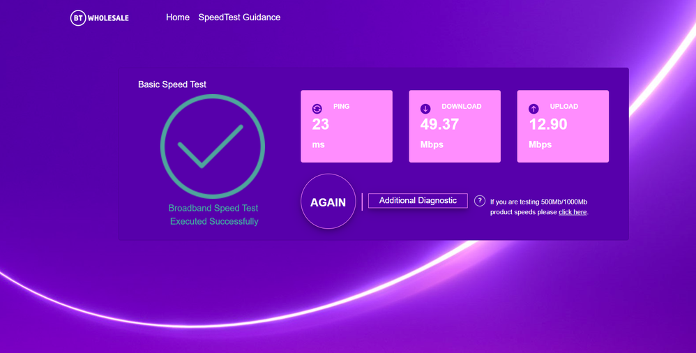

I recently moved to fibre extra (80/20Mb) and was previously on the standard 40/10...I've recently had an Openreach engineer test and confirm our line is capable of 74Mb down, but I'm only getting consistently 49Mb down and 12 up. This is only marginally faster than the previous package where speed tests consistently gave me 37Mb down and 9 up. The recent engineer visit confirmed there is nothing wrong with the circuit from my house to the exchange....Why am I still getting poor speeds? (an average increase of only 12Mb down does not seem worth the change...

@paddyhalfmonkey If the engineer confirmed you should be able to get a d/l speed of 74Mb/s, then we need a little more detail:
BT Broadband(obscuring your phone number) and BTW Performance Tester - Over a wired (Ethernet) connection if at all possible, please report the 'ADDITIONAL DIAGNOSTICS', and sight of the broadband connection status from your Hub (with the 'Username' obscured) would be a good starting point.

The router is plugged directly into the NTE5 master socket and I'm using an ethernet connection to my PC (doing the tests)
I couldn't work out how to get router diagnostics, but have recently reset it and has been rebooted since.

Cheers for those shots, @paddyhalfmonkey . As you can see from the first picture, the speed range for your connection is nowhere near 74Mb/s, so where the engineer got his thoughts from is anyone's guess.
Which Hub have you got, as the data from there is a vital piece of information?
