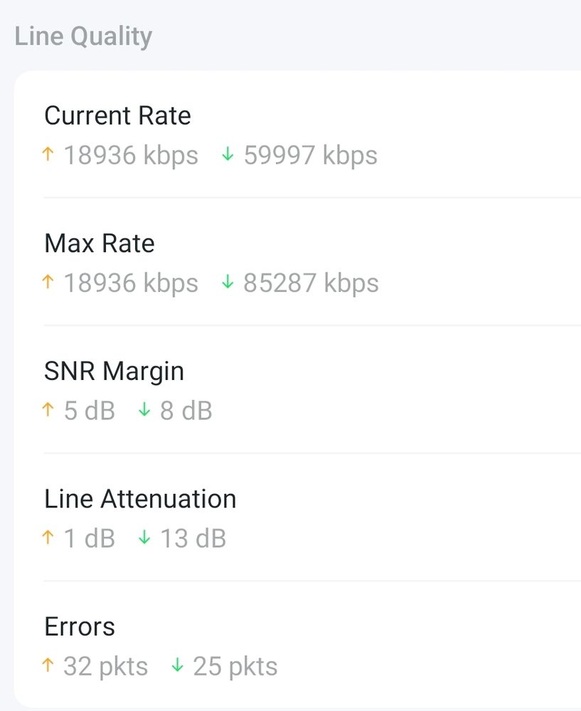

So for various reasons this has taken some time to get around to doing. Since the original post I've changed router but there are still occasions when we seem to lose speed completely.
SmartSelect_20230827_172005_Samsung Internet.jpgSmartSelect_20230827_171031_Deco.jpg

@pcurtis70 Which router have you changed to? Looking at the images in your post, you should be getting a better downstream speed than you are, but something still isn't quite right - your D/S SNR looks a little high, which appears to have banded your profile.

OK. I'm not familiar with TP-Link kit, but I assume it has the ability to report similar information as the PN Hub. Any chance you could post the equivalent data as the broadband connection status found in the PN Hub?
Re: Extemely variable performance - slow speeds
It looks to me that your line has been 'banded' at 59997Kbps down, due to current or past interference on your line.
Run through the Plusnet  troubleshoot by text.
If that identifies a problem, then Plusnet will fix it or send an engineer to take a look.
If it doesn't find an issue, then the last step asks whether you want Plusnet support to call you to help, take that phone call and ask them to check whether your line is 'banded' and seeing as no fault was detected by the troubleshooting just done, ask for the banding to be reset.

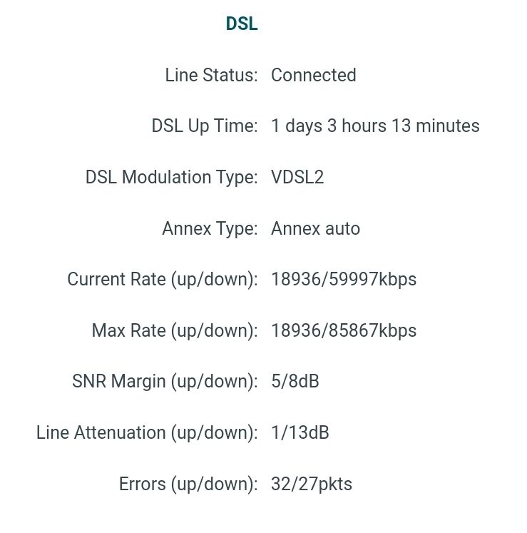

I'm not sure but these are the connection stats

Right - unless you have only very recently, like yesterday, installed that router, you are suffering from xDSL drops. As @Anonymous suggests, report a broadband fault via https://www.plus.net/help/report-a-problem/broadband/

@pcurtis70 - You connection is banding to 60 (0.128M-60M Downstream, Retransmission High - 0.128M-20M Upstream, Error Protection Off) however your sync isn't hitting this at least not right now @ 57.4 Mbps. I've request the banding is remove though a DML reset as I can't see any harm.
As your estimate is 55 and your sync is 57.4 I don't see an issue with that side of things and your line has been stable for that last month - http://visualradius.plus.net/visualradius/generated/image1693162435575.png
When the speed is low, how fast are we talking and have you got any other tech like switches or powerlines adapters or Wi-Fi boosters anyway or is it just the 1 router connected?
I'm seeing a fair bit of upload daily and hourly can you be sure that when it's slow the upload isn't being maxed out?
