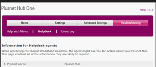

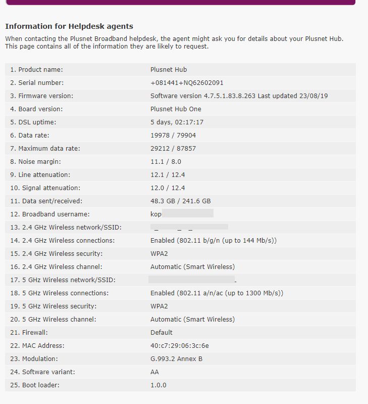

Re: Drop outs and occasional very slow (unusable) speed...
28-11-2022 12:30 PM
This is my help page. I blocked out some details as I just felt it was right on a public forum.
