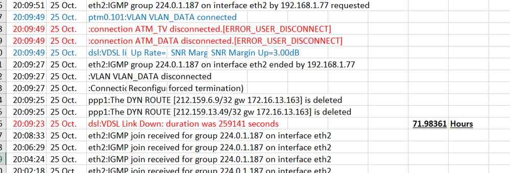

Ok, despite me already trying the old Hub One router a few weeks ago, having changed it back again this time seems to have resolved the issue to some extent.
It's not dropping out in the evening now, but we are still, albeit less frequently, getting a drop-out at more random times. It happened today during the day.
It could be happening more often, but it's not at a time we're noticing it.

20:11:19, 04 Nov. (787877.750000) WAN operating mode is VDSL
20:11:19, 04 Nov. (787877.750000) Last WAN operating mode was VDSL
20:11:18, 04 Nov. (787875.900000) PPP IPCP Receive Configuration ACK
20:11:18, 04 Nov. (787875.890000) PPP IPCP Send Configuration Request
20:11:18, 04 Nov. (787875.870000) PPP IPCP Receive Configuration NAK
20:11:18, 04 Nov. (787875.870000) PPP IPCP Send Configuration ACK
20:11:18, 04 Nov. (787875.870000) PPP IPCP Receive Configuration Request
20:11:18, 04 Nov. (787875.860000) PPP IPCP Send Configuration Request
20:11:16, 04 Nov. (787874.180000) PPPoE is up -​ Down Rate=79904Kbps, Up Rate=19999Kbps; SNR Margin Down=8.7dB, Up=15.3dB
20:11:16, 04 Nov. (787874.160000) CHAP authentication successful
20:11:16, 04 Nov. (787874.110000) CHAP Receive Challenge
20:11:16, 04 Nov. (787874.110000) Starting CHAP authentication with peer
20:11:16, 04 Nov. (787874.100000) PPP LCP Receive Configuration ACK
20:11:16, 04 Nov. (787874.100000) PPP LCP Send Configuration Request
20:11:16, 04 Nov. (787874.090000) PPP LCP Receive Configuration Reject
20:11:16, 04 Nov. (787874.090000) PPP LCP Send Configuration ACK
20:11:16, 04 Nov. (787874.090000) PPP LCP Receive Configuration Request
20:11:16, 04 Nov. (787874.090000) PPP LCP Send Configuration Request
20:10:24, 04 Nov. (787822.150000) PTM over DSL is up
20:09:48, 04 Nov. (787786.420000) PTM over DSL is down after 13128 minutes uptime
20:09:48, 04 Nov. (787786.420000) PPPoE is down after 13127 minutes uptime [Waiting for Underlying Connection (WAN Ethernet 7 -​ Down)]
20:09:44, 04 Nov. (787782.730000) PPP LCP Send Termination Request [User request]
I haven't touched the router, or done anything from a device (User Request?). And I haven't rebooted it either, the uptime of 2 days is a puzzle, it should be longer than that, unless it's rebooting itself?
Note that's it's a similar time to the outages on the BT Hub.
