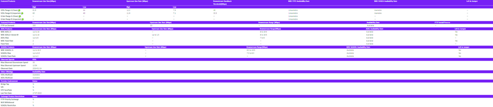

Hi, thanks for helping out - here's what I get on https://www.broadbandchecker.btwholesale.com/#/ADSL. 6cdb5bcbe3eef3423a1af3f8ec7def4a.png
Posts: 17,658
Thanks: 8,984
Fixes: 383
Re: Download speed gone down yet again
@sweeep1963 From that, it looks like you have an impacted (poor) connection, but your Help Desk/Technical Log would tell us more.

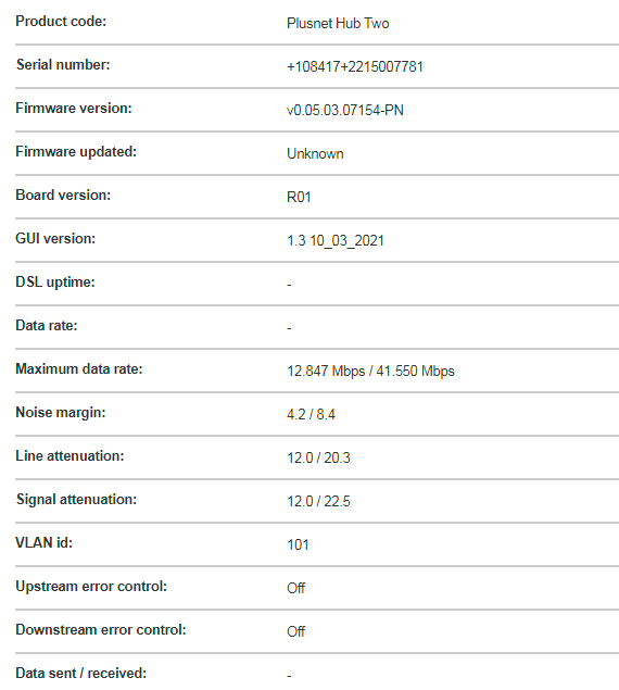

My current setup prevents me from seeing the current sync speed, though I can estimate it based on speedtests. The max data rate is around 42mbps, slightly lower from the usual 46-48. I tried a quiet line test, though unsure what to listen out for - all i heard was some very faint buzzing/hissing. On the phone call I had with plusnet I was told there is no fault, but all I'd like at the moment is for the line to be reset to see if that helps at all (it has in the past - see https://community.plus.net/t5/Broadband/Speed-capped-to-39-99/m-p/1933865 ) - especially with the SNR so high at the moment.
Posts: 17,658
Thanks: 8,984
Fixes: 383
What is your 'current setup'?
sweeep1963
Posts: 54
Registered: ‎25-08-2019
I'm using the plusnet router in bridge mode acting as a modem, connected to an Edgerouter X, which is connected to a wireless access point. (My previous modem was problematic causing drop outs so tried the plusnet router in this way and it has been fine ever since) The only issue is I do not have access to full modem stats - sync speed is missing, but the rest is visible.
Posts: 17,658
Thanks: 8,984
Fixes: 383
In that case, can we please ave sight of what is visible?
