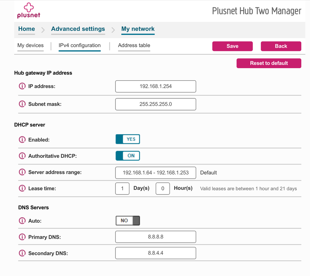

Okay, well, I now have a Plusnet Hub 2 on which it appears to be possible to manually set the DNS Server:
Advanced settings > My network > IPVv4 configuration
I changed the settings to manual (Auto off): primary 1.1.1.1 secondary 1.0.0.1 (Cloudflare). However, the DNS seem to be fixed to 212.159.6.9 and 212.159.6.9 at:
Advanced settings > Broadband > Internet
I also tried 8.8.8.8 and 8.8.4.4 (Google) and in both cases the DNS server addresses propagated to my devices (their DNS servers settings were set to automatic) but the linked Twitter video still will not play.
Annoying.

The DNS that you have set is what the DHCP server on the Hub2 gives out.  I don't think you can change what the Hub2 uses internally, which is what you are seeing on Advanced settings > Broadband > Internet.  I don't think it would make any difference to what the devices see (ie they would be assigned the Cloudflare ones you've put in the DNS settings), except (possibly) if you manually set the DNS on a device to use 192.168.1.254 (or any other DNS for that matter).

Well, to confirm the settings, here are screen grabs from my iPad's DNS settings for the Wi-Fi network (they are set per network) and the Hub 2 settings.plusnet-ipad-dns.pngplusnet-router-dns.png

@flamesong - Bit of head scratching from here to. I'm not aware of us blocking sites and content outside of safe of safeguard and for sure, a VPN would eliminate that. I notice the DHCP IP range of the Plusnet router starts 192.168.1.64. I don't think that is standard so have you set that yourself and if so why. No interrogation intended. I'm just curious to what the 192.168.1.1 - 192.168.1.63 is being used for?

@James30 The range of 192.168.1.64 - 192.168.1.253 is the default on the Hub2 (and the Hub1 if I remember correctly).
