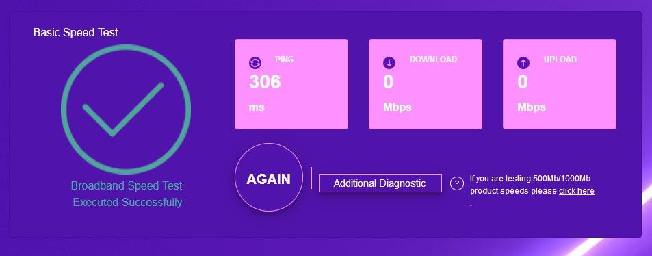

Hello, I'm back with the same problem. It's raining so I wonder whether it's the damp connections again.
Thank you for the comprehensive explanation, Anywho. I don't think bufferbloat is to blame here though, as the fault mode we experience is a consistent slowdown or failure across surfing the net, no matter what's connected. When everything's working normally, with our ~4MB connection it is possible to play online and have others watching catch-up television without undue problems and it's been that way for years.
I just tried DSL Reports now, and this is the result: http://www.dslreports.com/speedtest/70966729
It said it couldn't even test bufferbloat as latency was too high (>600ms). Today and last night the experience has been very slow or failed loading of pages. It improved momentarily last night when I rebooted the router, but it's obviously lost connection since, as from the snip below which I just made it's been connected for under two hours. BT Speedtest didn't load yesterday, but did just now.

Hi there and sorry that's started to be an issue again! Diagnostic checks aren't showing signs of anything obvious but if the disconnections are lining up with wet weather it would be best for us to arrange another Openreach engineer visit.

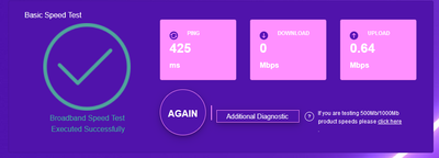

Perhaps the rain isn't the culprit - today is very hot and the speedtest/router stats are not good.
The Openreach engineer was extremely helpful, despite being unable to get anything concrete with his tests, but he could see the service had been very poor from his log of the connection over the past month. He's aware of the difficulties with our overhead line back to the cabinet as he's had to repair it when it's been rubbing against trees in the past. Unfortunately, there was nothing he could do without being able to meter the intermittent fault in real time.
Yesterday the router lost connection, and regained it after a reboot. Today the router reports the attached figures, and the BT speedtest is equally under the weather.
I've just made a telephone call and the line was crackling and popping.
