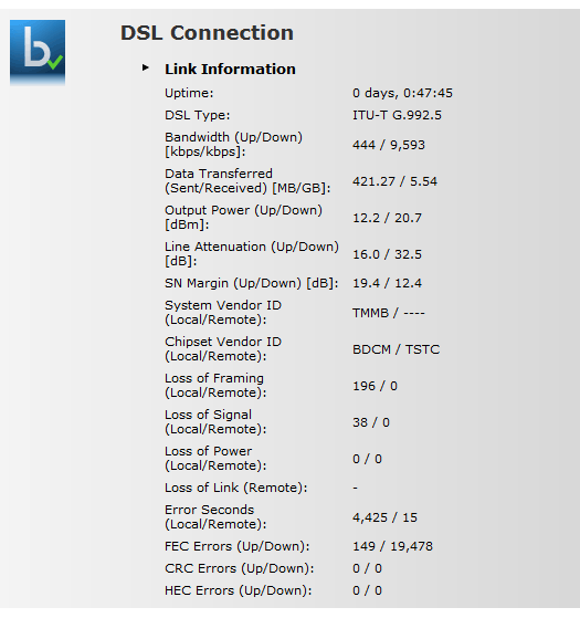

Re: Declining ADSL Speed
@pvmb Which modem/router are you using? can you post a screen shot of the data page - obscuring personal data, of course.

Posts: 25,374
Thanks: 9,191
Fixes: 388
@pvmb Apart from the low uptime I can't see much wrong there, It is a while since I've used a 582N, but don't they have a page that gives all that data and a bit more in a more readable format? I'll have to go looking at my old image uploads to find the one I'm talking about, so I'll be back if I can find it.
Something like this:-
