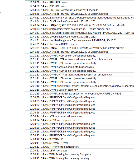

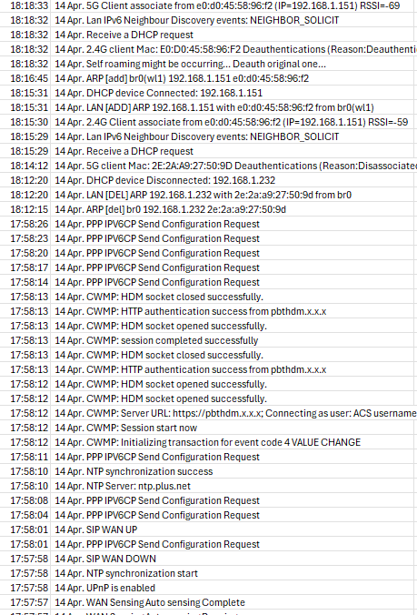

I'm no engineer but if I look into my router logs, I can see 988 instances of SIP WAN DOWN since August last year. That's not an insignificant amount, no? Perhaps I am looking at the wrong thing. They tend to happen in clusters, with the service going down say, five times over the course of 30 mins. Then it might be stable for a day or two, and the pattern repeats. I'm on Plusnet Fibre Extra.

Can you post a screenshot of the log around the time of the drops so that we can see if there's any clues as to the reason? Make sure to obscure any personal information.

Hi, thank you for your response.
I've attached some excerpts from the logs, let me know if that helps?
