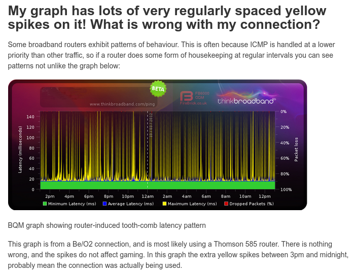

So this is the away graph in question -
PlusnetAway
and below is the explanation from the ThinkBroadband BQM FAQ -
Screenshot 2024-06-19 at 08-43-31 Broadband Quality Monitor FAQ thinkbroadband.png

I used to have an ADSL (not ADSL2+) connection with a low upload, and I never had a graph with latency as bad as the away graph. I may be that I was using a more competent router, but the amount of traffic generated by the BQM isn't enough to swamp the upload unless other traffic is present too.
The TBB info was written some years ago (the 585 is ~14 years old) - most routers are much better than they were then, so I wouldn't expect any relatively modern router to produce a graph that bad when the connection is quiescent.
