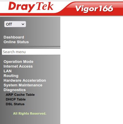

Oh ! sorry for the wild goose chase !,  I had assumed that the Vigor 167 had a similar web interface as the nearly identical Vigor 166 (that I have), but clearly from your screenshots it is completely different and unlike any DrayTek web interface I've seen before.
Most DrayTek devices have a menu that looks like some variation of this -
@Anunnaki that's because it's in modem mode,
Anunnaki
Posts: 120
Thanks: 50
Fixes: 3
Registered: ‎15-06-2024
Re: Constant High Latency Spikes; Frequent Dropped Connection
I'm not convinced,  my Vigor 166 is in "modem mode" and only shows traditional style DrayTek menus.
It looks to me that DrayTek have done the modern thing of showing a new pretty but dumbed down user interface on the 167.
If needed later, I might get @danielw to try getting the modem DSL stats using Telnet
but in the mean time figuring out how to get the UniFi to apply QoS to the VDSL upstream, and get that TBB BQM plot looking better.
