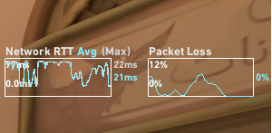

Also starting to get seemingly random ping spikes.
Ping statistics for 1.1.1.1:
Packets: Sent = 1140, Received = 1140, Lost = 0 (0% loss),
Approximate round trip times in milli-seconds:
Minimum = 17ms, Maximum = 189ms, Average = 18ms

Been playing a few games @jab1, and the ping spikes are really noticeable, packets also seem to drop in game whenever a lag spike happens, theres no other devices on the network that could be using the bandwidth to cause itimage.png
