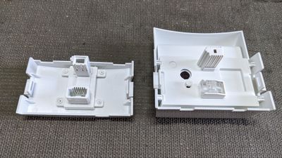

I've got a master socket 5c, and i don't think this has a test socket does it?
Posts: 4,997
Thanks: 3,305
Re: Connection issues with Microsoft Teams
@cs10 the faceplace just clips onto the 5c box and once taken off reveals the test socket.
Faceplate view from the back, left unfiltered faceplate, right filtered faceplate with two sockets.
You'll need a ADSL inline filter to connect to the test socket.
HTH
