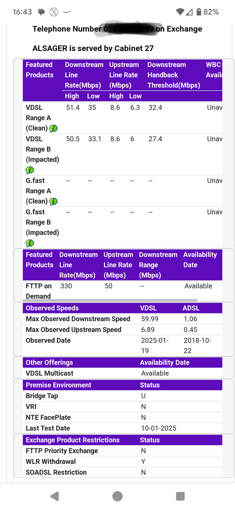

@MartinConnolly Without sight of the full output from here: https://www.broadbandchecker.btwholesale.com/#/ADSL , it is difficult say whether it is high  or low, but it certainly is banded. Obscure your phone number before posting the result, though.

@jab1 I have the output from the checker, but can't see how to attach it here!

Download data rates ending xx999 or xx998 are often associated with broadband lines that have been rate limited (lower than they could be).  The next thing to look for with a 'banded' (speed restricted) connection, is a noise margin with a bigger number than 6.0.
However in the presence of noise on the phone line, it is pointless looking at the broadband modem stats until the line is repaired and quiet again, with the modem left undisturbed for at least ten days to allow Openreach DLM (Dynamic Line Management) to recalibrate itself to the improved line conditions.
If I were you, when the phone engineer comes to repair your line's voice fault, ask them whether they are able to initiate a broadband "DLM reset" as you suspect the noise interference might have caused your modem to be stuck on a lower speed than I might now achieve.  I don't know how jobsworth phone engineers are to help you with that, as phone engineers fix phone faults, and broadband engineers fix broadband faults.  But it would be worth asking anyway, otherwise subsequently getting Plusnet support to agree to performing a DLM reset has at times been discouraged for various reasons.

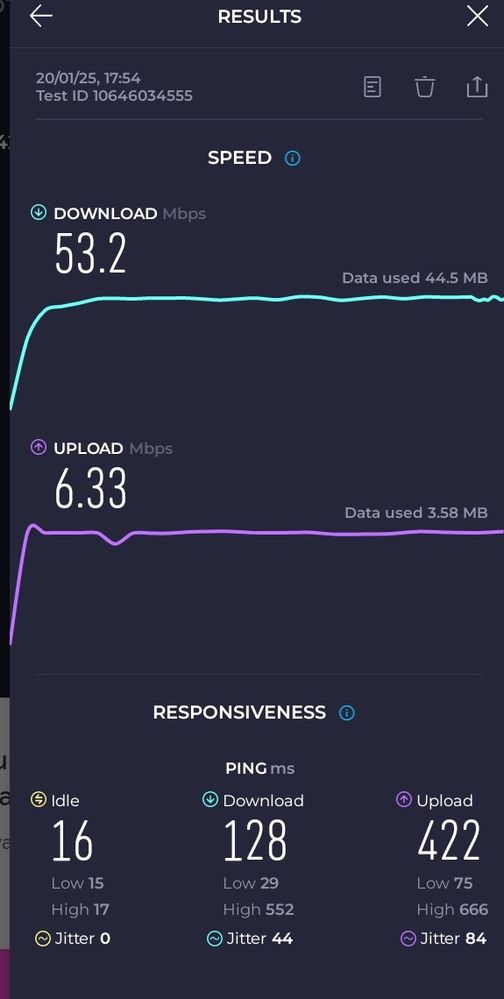

@MartinConnolly Interesting. What result do you get from this speed-test please - https://www.speedtest.net/ ?
Have you reported your phone issue? Until you do, and it is rectified, there is little point in trying to progress any further.

@jab1 here's the Speed test results. I have reported the phone problem but haven't spoken to Plusnet yet - it's been a nightmare of a day!

That speed test result looks 'about' right for your current stats, but with a noisy phone, they will deteriorate, and they are not likely to improve by much, although the upload looks a tad low, but as that is not a guaranteed figure any improvement will be a bonus.
