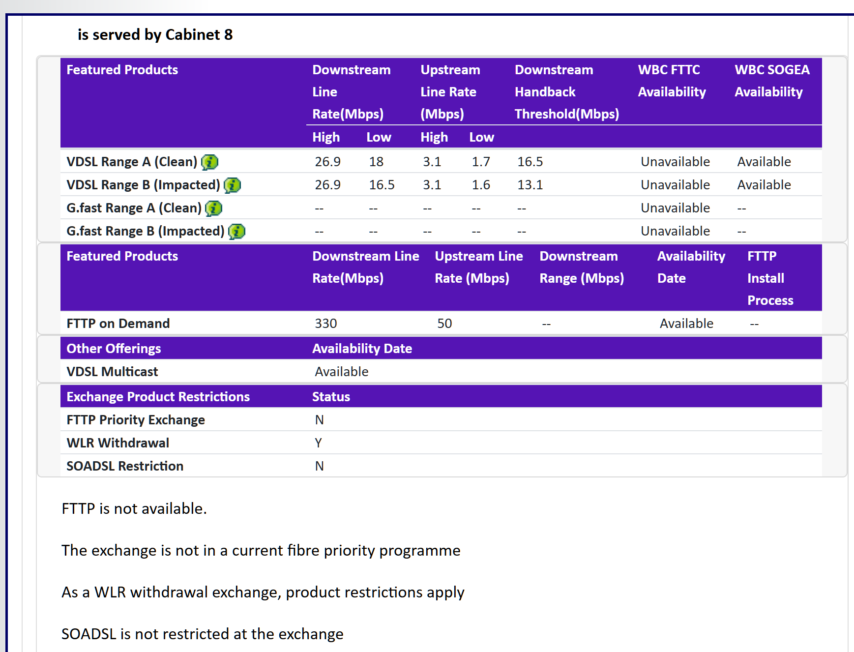

Our cabinet says its not available but SOGEA is. I'm confused now as i thought we had VDSL FTTC ?

If you have not negotiated a change to SoGEA (Broadband with no phone component) then you will still be on FTTC (Broadband and phone).
It appears to me that there is a fault somewhere in the Openreach network.

@milvusmilvus - does your user portal indicate the line's service number?  Look under "Phone" for the "phone service number" - if there is one there, try dialling it from a mobile.  If that encounters a 'fault' use the PHONE Fault BOT - see the link below.
@Marsh / @Windings - would it be possible for one of you to try the "magic" copper circuit tests here please?
This user does not think they are on SoGEA and there is no dial tone; that along with a limping broadband might suggest a single leg DIS.
