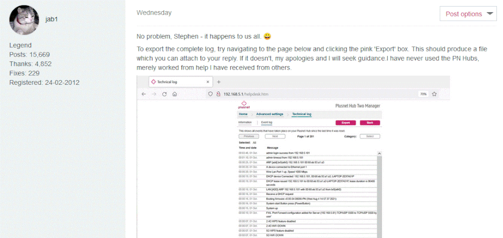

I'm not surprised that test came back as OK - they always do, and that refresh will have done nothing as the issue is somewhere in the Openreach network.
Can you do as Dan asked and post the 'all' category from the event log around the 1532 mark - before and after?

I'm unable to locate 'troubleshooting' on my Hub 1.

@greygit1  Are you sure?

Sorry for the delay, logs are attached.

No worries, Stephen - at least you are following through, which many don't. That log looks a bit 'unusual' to me, suggesting something is more than a bit wrong, but I'll leave it to @Dan_the_Van , it's a bit above my pay-grade to fully interpret it. 😉

Typo.
Should have stated Hub2, as I don't have a Hub1. And since I don't have a Hub1 it should be of no surprise I couldn't locate it.

And the example image you supplied was for a Hub2 Smiley

Err, no it wasn't.
This is a page from a Hub2:

I was referring to this.
Which is what got my confusion started and the resultant crossed wires.
