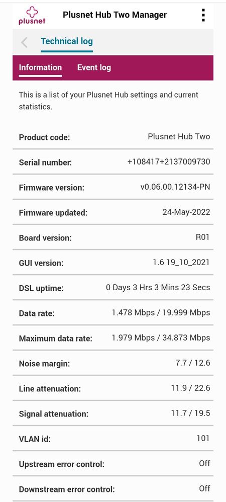

You need to post your Router stats (SNR etc) here, and confirm what connection type you have ADSL/FTTC etc;

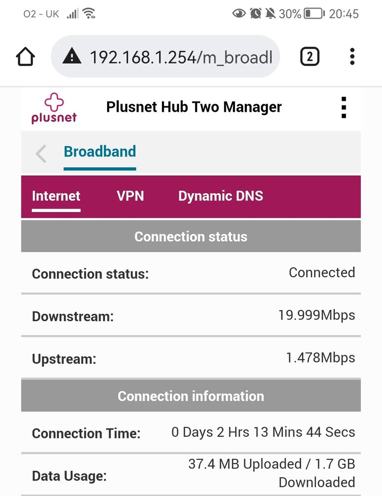

I believe my router snr stats are shown below
My connection is fttc I believe, minimum.guaranteed speed should be 27.3mb, but barely getting 20mb since the weekendbafter the constant disconnections, whereas before was getting 30mb on average.

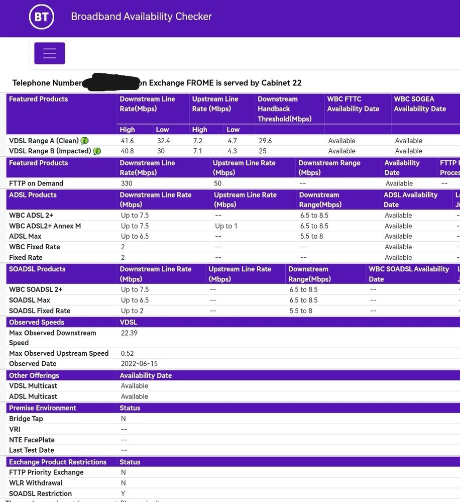

This is from the bt broadband wholesale checker for the cabinet which serves our area
