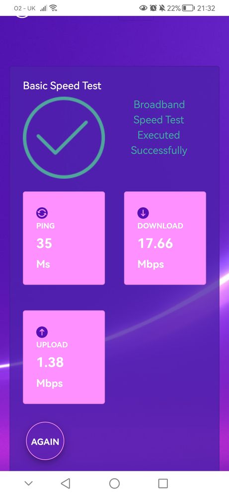

Over the weekend I experienced internet Dropouts and disconnections every few minutes or so, I lost count how many times I had to keep restarting router, restarting devices, yet still getting dropouts every few minutes even though no faults were showing in my area.
It kept saying on my phone WiFi authentication expired, luckily this now has settled down since Monday, all on its own which was very strange.

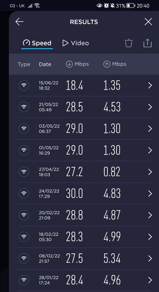

However since these multiple dropouts over the weekend my broadband speed is now at 20mb and upload barely 1mb, and is much lower than the guaranteed 27.3mb and 5mb upload I signed up for in January.
I had been getting 30mb download since January, now all of a sudden this is much lower than my guarantee.
Could someone look into these dropouts I've had, and also my poor broadband speed as this is much lower than my guarantee and what my line is capable of, I'm not sure if my router is faulty and this is why I had multiple droputs and now poor download speeds.
Ill try to attach my speed history since January 2021 when I joined Plusnet, to highlight the difference in what I was getting to what I'm.getting now.
I appreciate this being looked into and rectified please

Hi thank you for your reply
I believe my router snr stats are shown below
My connection is fttc I believe, minimum.guaranteed speed should be 27.3mb, but barely getting 20mb since the weekendbafter the constant disconnections, whereas before was getting 30mb on average.
My bt broadband speed performance checker results listed below.
