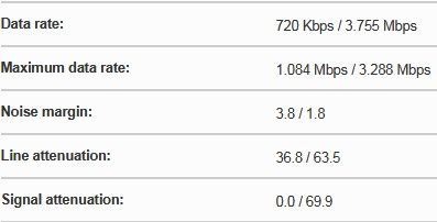

Since posting, and seemingly nothing being done, my line is returning to what it was before the OR engineer visit.
(The reported 'noise margin' on the hub2 does appear to be dynamic - it changes).
To answer your question. The hub2 is currently plugged into the filter that shipped with it. The (recently installed) mk4 faceplate is having a rest on the floor. There are no telephone extensions in the house. The only devices connected to the BT 'master' socket are the hub2 and a telephone.

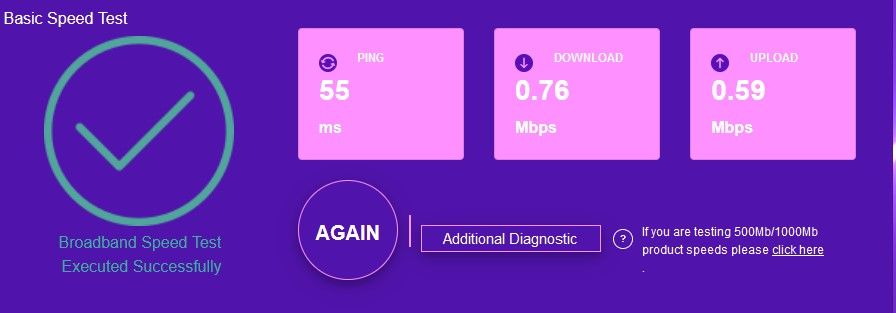

An 'interesting' BT speed test from the 27th July.
Not that 'bad' for a flakey ADSL connection, eh? Smiley

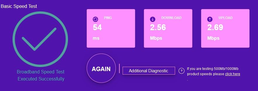

But two minutes later...

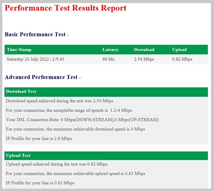

Other (previous) tests results (23rd July)...
