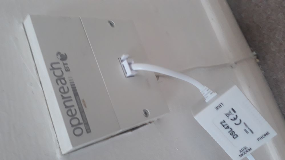

@MisterW this is what it looks like
Is this a master socket or a slave socket?
Thanks in advance
Posts: 18,574
Thanks: 7,917
Fixes: 530
Re: Almost a day and I still haven't been connected to the internet.
I cant be absolutely certain but I would suggest that's a slave.
It only has one phone socket and the wire coming up from the floor is the internal type cable.
If I'm right, and that's the case that socket is connected internally to a master socket somewhere else, then there's a pretty good chance that its connected to the filtered side of the master socket and you wont be able to use that for an internet connection without some changes to the internal wiring.
