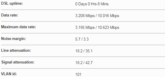

Can you post the statistics from your router showing the line speed of the connection?
There are different possible causes between low speed on a fast connection, and a slow connection.
Re: 5mbps ...........Really plusnet ????
@Portishead200
OK, have you tried logging in to the router and seeing what it says about your actual and maximum connection speeds?
Assuming that you are using a Plusnet Hub2 router, using a web browser on either your phone or laptop, go to 192.168.1.254
Click on "Advanced Settings", (bottom right), then "Technical Log", (on the left). Unless you have changed it, your router admin password will be on a pull out card on the back of the router, and on the back of the router itself.
Report back with your:
Data Rate
Maximum Data Rate
Noise Margin
I will log into the router now and check , I have just restarted it & check the cabling from outdoors to the router and all seems normal and untouched,

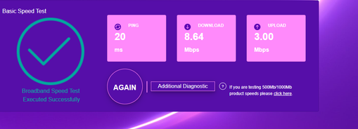

Portishead200
Posts: 51
Thanks: 5
Registered: ‎26-08-2016
Posts: 25,259
Thanks: 9,130
Fixes: 387
@Portishead200 You have a fault - use the 'report a broadband fault' link in my original post.

willcutforth
Posts: 1,718
Thanks: 80
Fixes: 113
Registered: ‎27-11-2020
@Portishead200 I can see the diagnostics bot worked and it is now with Openreach. It should be fixed within 72 hours.
