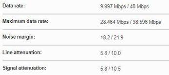

Thanks for the data, @AndyD2 . As @paul_blitz says, your 'jitter is bad, but what he hasn't spotted (or commented on) is your D/S noise margin - although looking at your attenuation figures, I would expect it to be a bit 'high' , but 21.9 looks a little excessive to me.
That's to be expected because the line is provisioned on a 40/10 profile and is actually capable of much more.

Looking a the Hub two Technical Page, the important figures
Looking at the Line attenuation you appear to have a short copper last mile from the Green Cabinet
What is your current product, from the Data rate to me it looks like your are on Unlimited Fibre.

23-10-2024 9:44 AM - edited 23-10-2024 9:46 AM
@AndyD2 You are going to struggle with all the devices on your network with your 40/10 FTTC service, Your router stats show you are on a short line to the FTTC cabinet so in the past it would have been possible to upgrade to the 80/20 product known as Fibre Extra. However because of Openreach rules on removal of the PSTN phone service the old FTTC products are no longer available and have been replaced by SOGEA broadband only products.
But surely that's 'good', not bad? Is it not a simple consequence of a limited fibre connection (40/10) on a line that can, in principle handle up to 90Mbps - going on the router information? I am the same, my "Max line rate" is around +70Mbps and on a 40/10 connection I have a download SNR of around 15dB.
PS. See this has already been pointed out, above.
