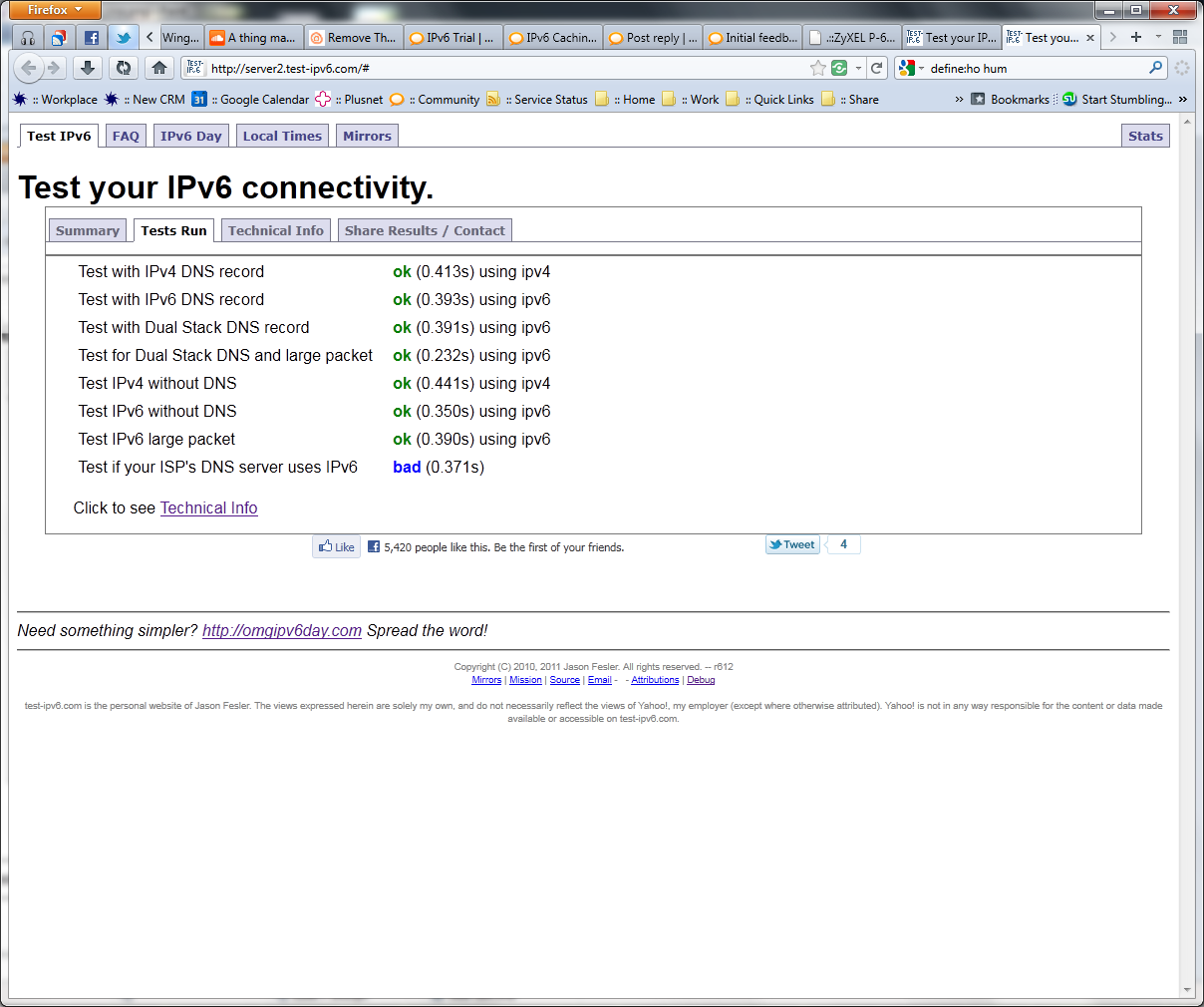

bobpullen
Posts: 17,049
Thanks: 5,275
Fixes: 327
Re: Zyxel 660HN-T1
And after explicitly setting Hurricane's DNS address in the IPv6 NIC properties...
