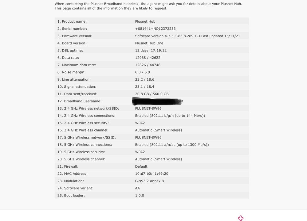

I think I found it

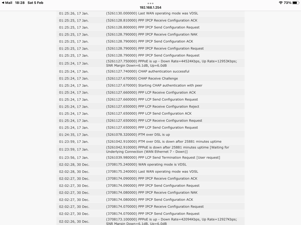

Thanks for the info in that long post, @Ripplyuk - although it is not that helpful (not your fault) - the BTW report (the first one) is a little out of date, the second one (speed test) is a false one with that reported D/L figure.
With regard to the data from you Hub, I assume the short up time is not due to you disconnecting, but due to DSL drops caused by some error on the network. The logs provided are not what I need, unfortunately - if you click on that panel, it should open to also give you the 'WAN' logs, which are more informative.
To get the 'Additional Diagnostics', click the button so marked on that report.

Thanks for that 'Additional Diagnostics' - there is something funny going off there - you are getting more speed than the IP profile - but less than what your line and signal attenuation suggest you should be possible.
Forgot to mention earlier, but the phone should be silent, apart from the 'Quiet Line Test' message.
In my opinion, this needs revisiting by Plusnet/BTOR.

@jab1 Is this right? Sorry if I’m posting rubbish.
Re: Broadband not working at regular times daily
05-02-2022 6:35 PM
@Ripplyuk Yep, that's the one, and it confirms my suspicions - you are losing DSL (PPPoE) connection more often than you should be.
