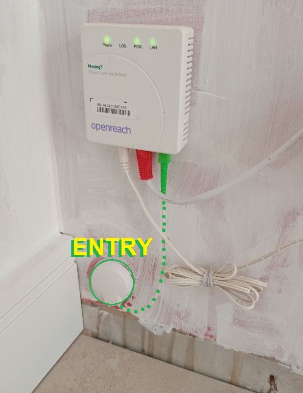

Are you saying that the ONT does NOT have to be right next to the entry point as in the example below? i.e. all on the gable wall
I have coloured the "optic" lead from it's entry point in that circle to ONT box for my own benefit.
Are you saying they could put that entry point on the external gable wall then run a lead from entry point to the actual ONT box which could be placed on the wall near the door, then plugged into the single power point on that wall (see picture in my post #15 ).
I thought the installations were all fixed and the same by Openreach (whoever), and the ONT box has to be right next to the entry point (circle) as the cable is very fragile and can't be bent etc as per the photo?

16-07-2025 1:57 PM - edited 16-07-2025 1:59 PM
No sorry, forgot to put I found it elsewhere on this forum. But a great example of how I believe they would fit it, entry point and ONT box right close to each other.

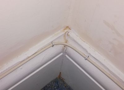

Sorry to be the cause of "palpitations" but it's better to ask now than wait until the day of install. My understanding is OR will run up to 10m indoors so long as they don't have to do any extra work. The pictures below are from my install.
As you state the fibre cable is "fragile" so can't do tight bends etc. If I'd been more organized I might have had duct preinstalled to take the cable (or at least have it to hand so It could be installed once the route had been agreed while work was being done elsewhere).
It is entirely possible the the ONT could go near either of the power points in the box room if you're happy with the cable run from the external wall (or have duct available to install once the route is agreed).

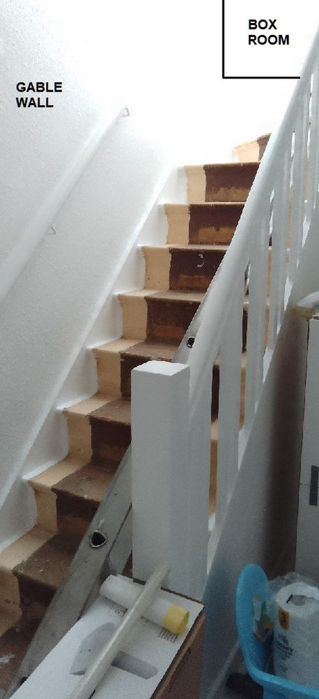

Okay, think you are all sick of my posts and diagrams now, so last 2.
Staircase, gable wall and box room at top of stairs, landing window not included!

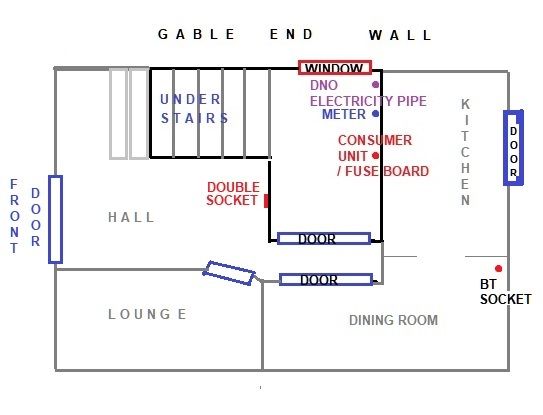

Here's a rough plan of the downstairs showing pantry (L shaped in black!), double plug on other side where we want router etc. There is only this one plug socket in the hallway.

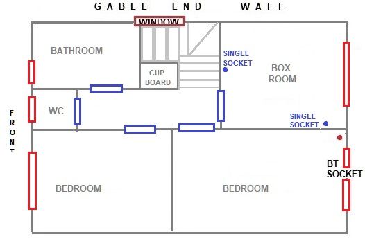

16-07-2025 7:56 PM
And upstairs 🙄

16-07-2025 9:26 PM
Based on your diagram and the belief that an electrician can wire in a socket in the pantry I think this is a valid option for an ONT. Hopefully others will jump in with an opinion.
The fibre could come in to the left of the window. Assuming there's nothing on the wall behind the double socket the cable could go up to the roof of the pantry, accross the gap under the stairs and then down to an ONT somewhere on the wall to the left of the door. A power socket could also go there or perhaps just around the corner under the stairs. If you put in a double socket you could potentially run both the ONT and the router from it leaving the hallway free.
You then use a face plate like the one I posted (there are many options on Amazon) to create a hole for the outgoing ethernet cable. I'm not certain but I think the router power lead may be 2m.
To me this is the optimum solution. Cables largely hidden out of sight with no ethernet cable run required from upstairs.
