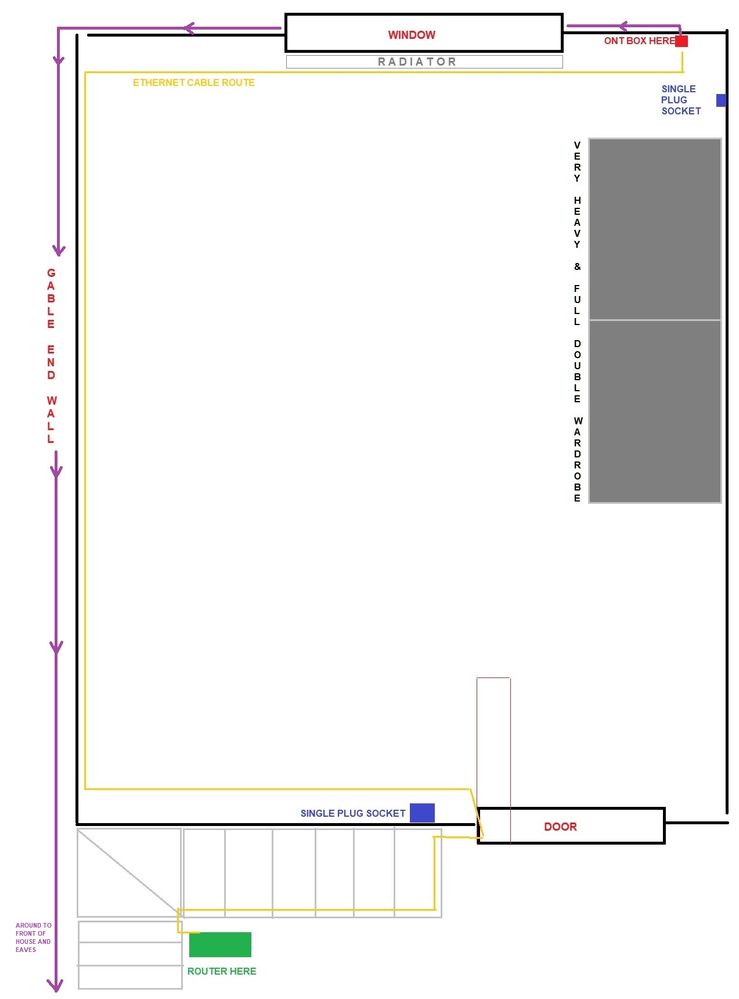

@Baldrick1 Just too long a route with archways and two doors to overcome with very long ethernet leads. Plus (drum roll), there isn't a power socket anywhere near where the BT socket is in the dining room.
Sorry for sounding nit picky and ungrateful, it's NOT my house and my OH doesn't want loads of extension leads, cabling, power points etc etc .

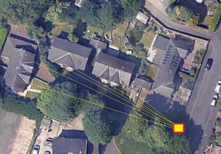

Can you draw on the picture where you want the fibre cable to go externally? I'm trying to get a picture of what's required.

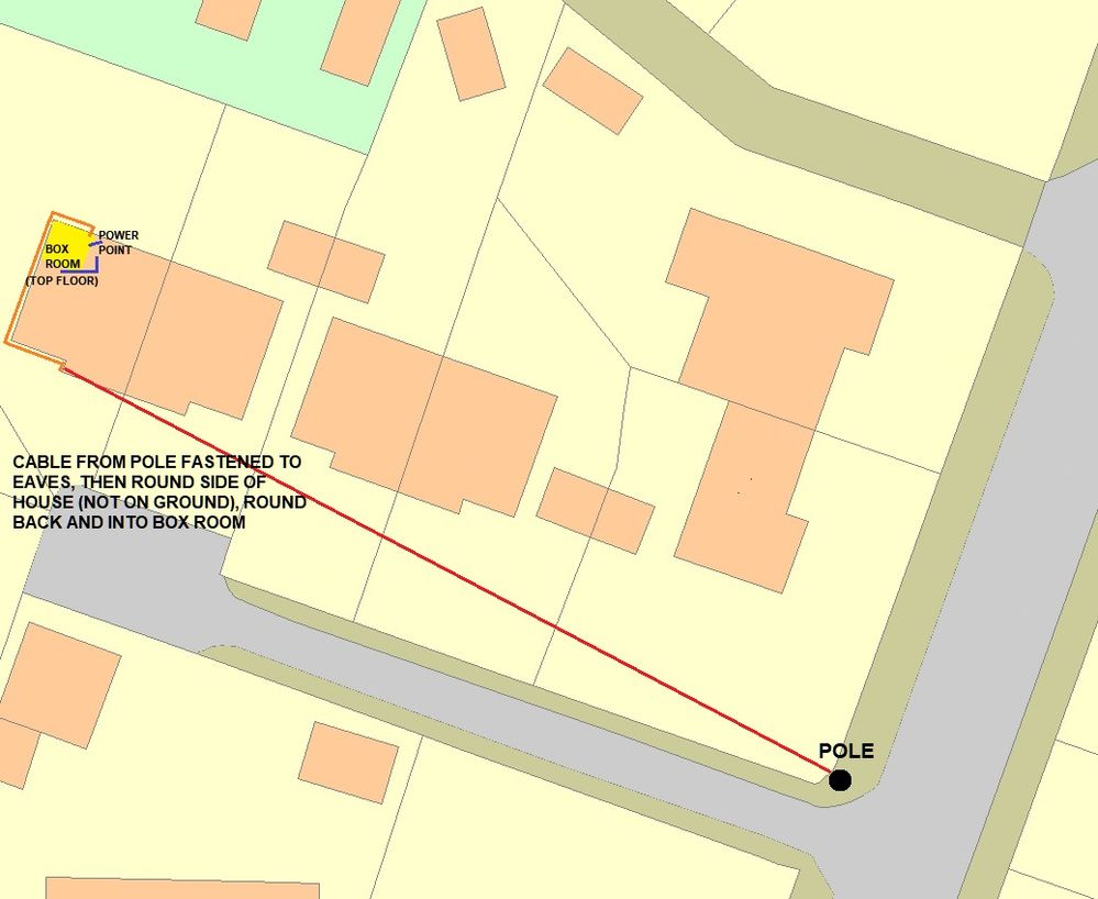

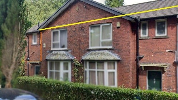

The current phone line comes from the pole, fastened to a "hook" under eaves, then it comes down a few feet, above the front door, all the way round the side of the house (damp gable end wall), round corner above back door then into bedroom (to the right of the box room). I thought FIBRE would follow same route, cabled against pointing (i.e. off the ground), then round and this time into the box room, pictured.

Sorry, cable out route from ONT box round to front of house diagram now added

My initial reaction is the OR engineer will say no to your desired location. Fibre optic canle doesn't bend to well so would stick out when going round the corners of the house. Perhaps more to the point OR being OR have a Health and Saftely rule that when working at height ladders ladders must be fixed to the wall. This entails (I believe) drilling two small holes to attach the ladder to. All in all, this leads to too much work (time) to get to where you want to go.
As previously stated you just never know until the day. In this instance you must have a back up location chosen in case they do say no.
You might convince them to go round the side (one corner). ONT on the gable wall using the power socket near the door.

I'm not saying outright they'll refuse. I'm saying that I think they will. You just don't know until the day hence the need for a back up location.
You may have already said but what's the upstairs front room. If it's a bedroom could it go there, then run an external ethernet cable round the back of the house and back in under the stairs.
