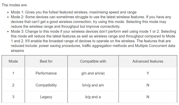

The Hub Two has hidden wireless networks (2.4 and 5 GHz) which are a legacy from the BT version, they (hidden wireless) cannot be disabled.
There is an option to change the wireless mode setting; I would try 2 to see of that helps
The setting link  http://192.168.1.254  Advanced Settings >Advanced Wireless. Don't forget to save any change.
Worth a try
HTH
