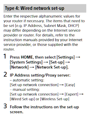

The Sony EU site https://www.sony.co.uk/electronics/support/res/manuals/4689/46896421M.pdf confirms that path ->SonyTVIntWired.png
It seems IP Address setting/Proxy server should be taken next. Is there an "Auto" setting next? Or is it "Set up network connection" and choose "Easy" or "Expert"? Not clear from their description.

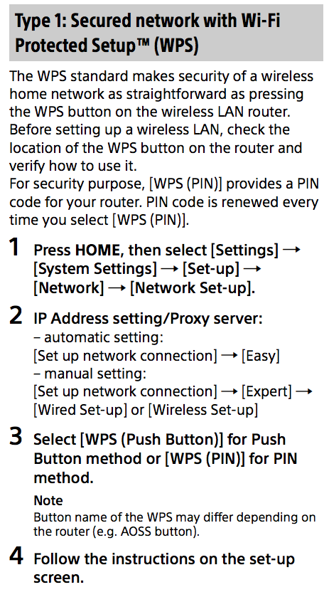

My bad Dave, it's a wireless set up and my router has a WPS button. The relevant part of the manual for that is:
With my path being Setting/System Settings/Set-up/Network Set-up then a choice of'Status', 'IP Address Settings' and 'Connection Check' the relevance to the guide stops at 2 IP Address Settings - there isn't a 3 Select [WPS (Push Button)] etc option.
Thanks.

If you take the IP Address setting option isn't there an Auto under that. Alternatively Set up network connection with further options of Easy and Expert? Though I wouldn't have classed using the WPS button as Expert.
