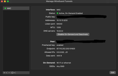

yeah its virtualization in docker! using Hyper -V rather than WSL  on windows server! that's what the server is i'll give the bridge a go and see if that resolves the issue.. i know the router is over-kill right now, but i am planning to get FTTP and cabling the house up with a 10GB connection everywhere (Future Proofing) i've already got a home-lab set up i just wanted to get this VPN working on both my 2 laptops and the network and my phone.
here is my settings :
[Interface]
PrivateKey ="KEY"=
Address = 10.13.13.3/32
DNS = 10.0.0.2
MTU = 1200
[Peer]
PublicKey = "KEY=
PresharedKey = "KEY"=
AllowedIPs = 0.0.0.0/0, ::/0
Endpoint = timski.ddns.net:51820
Wirguard UP and running on the macWirguard UP and running on the mac
i hope this helps you all
Thanks for all the pointers
tim
Posts: 4,997
Thanks: 3,306
Re: Plusnet UDP block list
@timsansom
My wireguard key looks much the same
[Interface]
PrivateKey = <redacted>
Address = 10.5.5.3/32
[Peer]
PublicKey = <redacted>
PresharedKey = <redacted>
Endpoint = <static public IP Address>:53264
PersistentKeepalive = 25
VPN connections through double NAT which what you have can be problematic so using a Bridge interface rather than NAT for your virtual system would be advised. It only costs one of your 253 available IP Addresses
I decided to use a couple of raspberry pi for my VPN servers, started off with openVPN but moved to Wireguard. I came across this site which simplifies a VPN installation https://www.pivpn.io/
I've use Oracle Virtual Box from my works days, so on a VM guest I have used that link to create a VPN on a debian lite distro, the required disk space can be just 16Gb, used a 'Bridged Adapter'.
I have found with some system (linux) a VPN connection can be set to always connected, not really necessary when connected to you local network.
