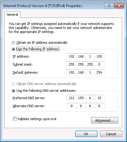

You could try explicitly configuring your network adapter properties rather than rely on DHCP?

Sorry, what is DHCP?
Where do I find that Internet Protocol screen?

Dynamic Host Configuration Protocol. Your router has a DHCP server built into it that automatically configures the devices you connect to it by assigning them a local IP address/DNS servers etc.
By carrying out the following, you'll bypass this and therefore rule out the possibility that the problem is related to DHCP assignment.
  • Start > Control Panel > Network & Sharing Center > Change Adapter Settings.
  • You then need to right-click your network adapter and left-click 'Properties' in the context menu.
  • Highlight 'Internet Protocol Version 4' and click 'Properties'.
  • Make the changes suggested above (assuming the address of your router is 192.168.1.254?) and then click 'OK' twice.

Thank you. Smiley
I have to go and do some gourmet piercing film several times just now but will try that later.  Microsoft updates will install tonight so I'll see how it goes.

The router assigns an IP address to your network adaptor using DHCP.  The router then has to distinguish between long periods of inactivity when the network adaptor is not in use but the computer is still connected and the situation when the connection is broken or the computer is switched off.  So either the router is failing to recognise when the computer is briefly shut down or the network adaptor somehow remains powerrd-on through a restart of the computer (but the computer loses its memory of any assigned IP address etc).  So, basically, either your router is faulty or your network adaptor is faulty.  Either way, setting fixed parameters for the network adaptor (instead of using DHCP) should work around the problem.
