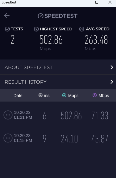

Before and after a reboot speed test...

Ok, so I had a spare wireless dongle and connected via that and the speed was still low, so that eliminated the Ethernet card. I didn't have TurboLan or CfosSpeed installed either.
Also thanks @RealAleMadrid  - Running it in Safe Mode, it remained stable at 500/70 for prolonged time, so at that point it had to be software related.
My first (and final) thought was the firewall software, I have Zone Alarm Extreme Next Gen installed. Uninstalled that and et voila no speed loss! Been logged on for a couple of hours now and still at over 500Mbs 😀
