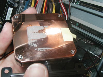

Having done some digging on this it looks like 70degC on stock cooling under load with that CPU is a little high.  Assuming you've checked the basics (airflow around the cooler, removal of dust etc) i'd recommend that you remove and re-install the cooler in the first instance.  Most stock coolers come with a heat pad or pre-applied thermal paste and is generally not the best.  Also, the trick with CPU cooling is the contact between the cooler and the chip.  It's worth removing the cooler just to check that the cooler has a good contact with your chip.  The full surface of the cooler should be in contact with the CPU.  Something line this:
Is not going to give you a good transfer of heat between the two and may be causing your high temps.  It's worth investing in a high quality thermal paste to use when you re-install your cooler.  I can personally recommend the Arctic Silver products which can be had for a few pounds and tend to last a while.  Only a thin coating is required.  If the thermal paste is too thick this may also reduce the performance of your cooler.
