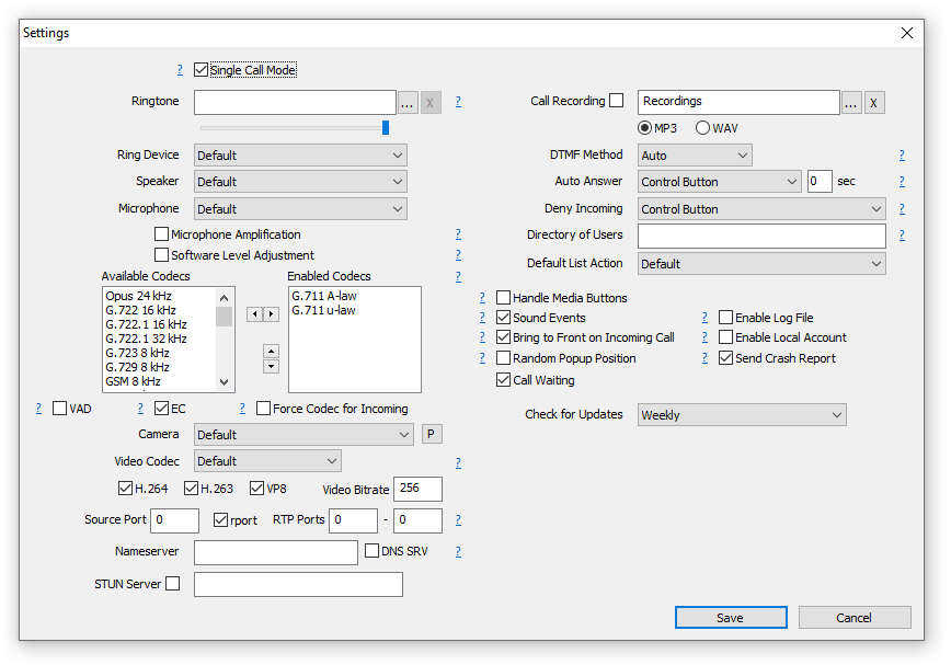

@Charles101 wrote:
the MicroSIP software of course is purely on broadband via ethernet and I don't see a port setting
Try putting a different SIP port number and alternative RTP port range values in here -
Once the PAP2T and MicroSIP are on different port ranges, I suggest rebooting your router to clear any previous NAT routes.
