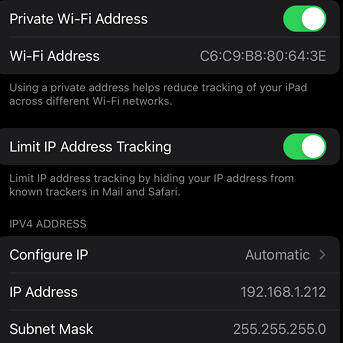

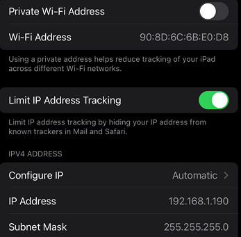

@Wildroverandy  For info: Just tested your comments about private Wi-Fi settings on my iPad.
The device will retain IP & MAC addresses until it’s powered down then there’s a new MAC address and the IP address moves on by one.

Normal use : (fixed IP device 192.168.1.190)
Private Wi-Fi : (DHCP range for non fixed IP devices 192.168.1.210-230)
Private Wi-Fi following restart :

Re: Ipad Privacy warning
@Wildroverandy  Bit more Info :
His 'n Hers identical iPad Air 2 Private Wi-Fi enabled.
Following re-boot His MAC & IP changed, Hers didn't.
His 'n Hers identical iPhone SE Private Wi-Fi enabled.
Following re-boot Her MAC & IP changed, His didn't.
Illogical.......
