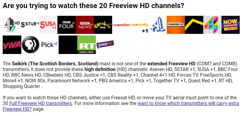

Selkirk TX

I've just noticed that on the Selkirk transmitter certain channels are being removed for 5G use by June 2020. Just on the off-chance, have you done a retune?
CANCEL THAT! Don't retune until you have looked at the remaining connections otherwise you will lose the bad channels completely if you retune when the signal is very low. The machine will think that the channel isn't there.

And are these the faulty channels?

No, the ones in question are BBC1, 2, Scotland, ITV, Channel 4 and 5 HD and an SD channel whose name I can't recall.

That looks like channel 35...   You can check the signal strength and quality on the Humax, but I think it has to be a connection dry joint somewhere in the coax line.
