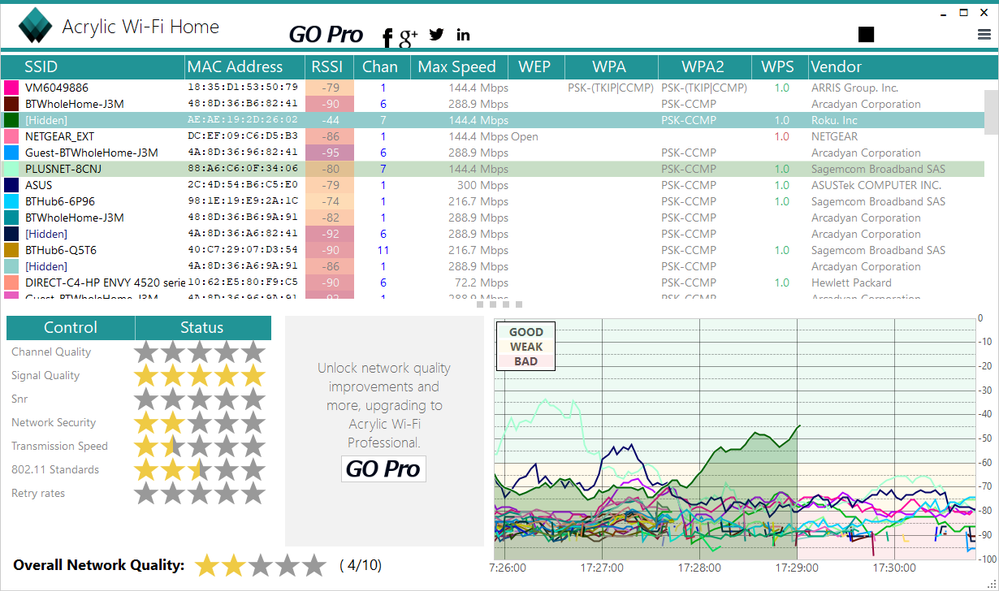

@idonno I see your point that if the hidden zone moves with the channel, so, when I move channels, it moves with it, so it must be linked Smiley
So both must come from a local device/s in my domain area
My strategy :- I've just downloaded some Wi-Fi analytical software for a tablet PC and I have managed to isolate the  "hidden" signal as the main signal.
Now I need to check if  the "hidden" signal is weak or strong in every corner of my location Smiley
When it gets strong, I will slowly turn off anything, one item at a time, and when I kill the "hidden" signal, I've found the problemCheesy so watch this space 🙂

Found it Smiley and killed it (as screen shot shows).
It's been a great learning curve for me and thanks for all your suggestions.
It was an amplified TV Ariel and moving it away from a laptop using Wi-Fi and on to a suppressed power outlet has fixed the problem 🙂
Can you tell when I cut the power to the TV areial that was my hidden Wi-Fi :-)Can you tell when I cut the power to the TV areial that was my hidden Wi-Fi 🙂
