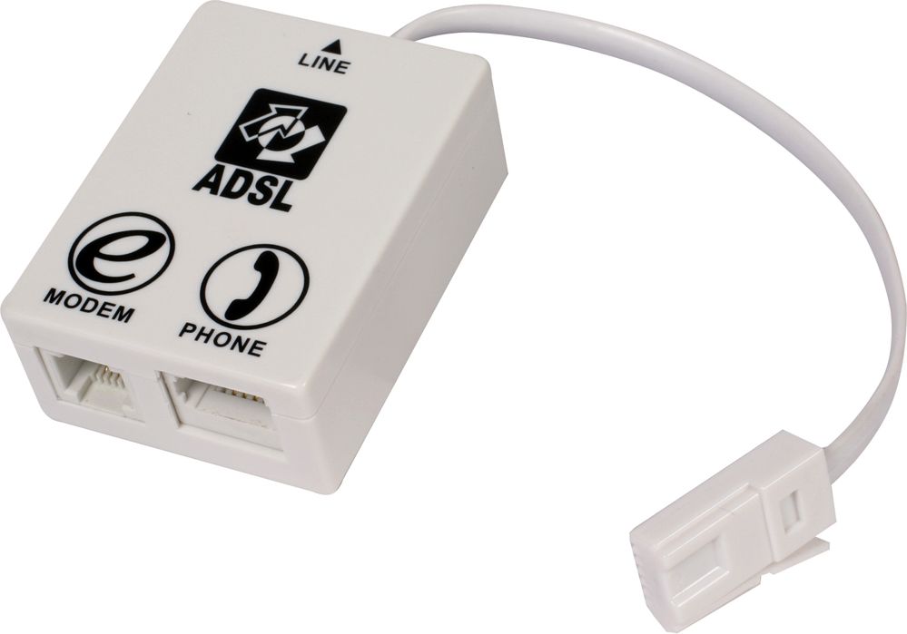

Use one of these so you can connect your internet to the test socket ![]()
adsl_microfilter
