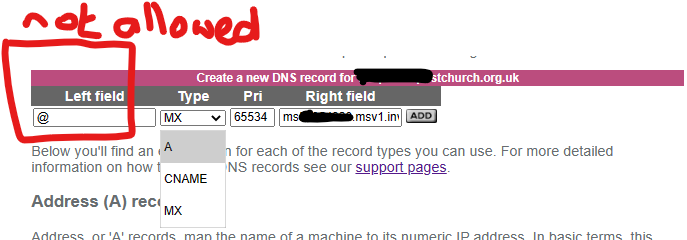

I created a MX DNS record yesterday evening to allow me to confirm my domain ownership with Office 365. "4 hours later it's not been published.
I didn't put anything in the "left" field - should i? If so what ?
mx 32767 ms56----.msv1.invalid
Any other thoughts?

17-09-2021 8:26 PM
Thanks for the thoughts - the DNS hosting provider is PlusNet!
The UI doesn't offer TXT records (which I've always used elsewhere), nor permit the use of the @ in the left side.

06-10-2021 9:00 PM
Finally got there. Unusual system, but I think I can see why...
Left: Full domain name with trailing . (period)
type MX:
right: Full name with trailing .
| knaphillbaptist.org.uk. | mx | 65535 | ms77719679.msv1.invalid. |
I think my assumption was that I was working inside the zone having selected the domain on the previous screen, so didn't need to qualify the left side. When you think about it from Plus' side - they could be doing this for any domain they hold, so need a FQDN on the left.
Now to work out to bypass the office 365 requirement for TXT records for SPF...
Or move the DNS elsewhere! Sorry Plus - time to update your systems. SPFs are near compulsory these days.
